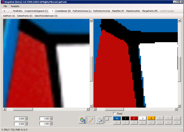

If you open the application, you can open a bitmap (currently only .bmp) – it will be shown in the left half of the GUI.
.png   Clipboard01.png (Size: 144.44 KB / Downloads: 881)
Now you can choose colors for the color quantization by right click on the source image (select the background color first). The result will be shown in the right half of the GUI.
It is the base for the path findings (around the areas with the same color). After choosing the colors it is possible to clean the result a little bit (and to remove the obsolete areas in the background).
.png   Clipboard02.png (Size: 204.78 KB / Downloads: 881)

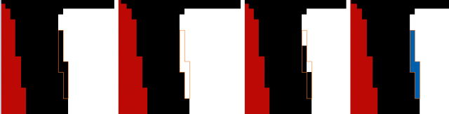

You can search for the paths now, by clicking the 'FindPaths' button. The result will be shown on top of the original image.
Again, a little bit of cleaning can be done (here undo is possible):
  • Select one point and create a circle (with the connected points); you can define the number of points in the circle.
  • Select more then two points. The points will be projected on the line between the first and the last selected point.
  • Select more then three points. The points will be projected on a circle. The first and the last point will not change. You have to select the points in the right order.
  • Select two points. They will become one at the cut of the connected lines.
  • Select more then two points. The distance between this points will be recalculated. Here you also have to select the points in the right order.
  • When you have selected one point, you can delete it with pressing d-key.
  • When you have selected two points, you cann add a point between them by pressing the a-key.

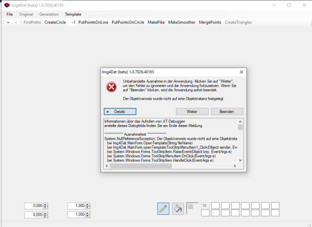

you have to fit the template to the image. By using the 4 NumerUpDown fields in the left bottom area, you can scale and move the template. It works the easiest if you select the field and use the mouse wheel.
And I think that this is also the reason for the exception. You added a template, but did not move it, so that there are negative values in the 'template path'. Currently the application can not handle such situations. I will catch them in the next version.
So now, you either can move and scale the template or you can create the triangles without a template (but then the size will not match the needed one). Does this help?
I will try to add the 'multi-delete'.

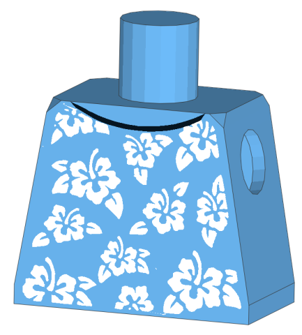

http://www.ldraw.org/cgi-bin/ptdetail.cg...973p9e.dat
Is it necessary to say more? Wink
More seriously... I found the cleanup time to be somewhat painful (eg. I missed a "merge points to average" function). So I used another method: first recreate a clean image with a vector drawing program (here Corel Draw X5), exported as bmp, processed with Img4Dat. Almost done... just had to change colors to proper LDraw ones, correct a colinear triangle, place the torso faces at the right place.
Great stuff!

When i want to open a template, I got this error:
Any idea?
If nothing goes right, go left.
Reply
RE: Img4Dat
#31
(2019-04-06, 19:01)Johann Eisner Wrote: When i want to open a template, I got this error:
Any idea?
Hey,
when you open a template, the tool tries to center it on the image that should be converted. But I think you did not open an image - so it is not possible to center the tempalte. I should catch that exception.
Rolf

RE: Img4Dat
#32
(2019-04-06, 21:09)Rolf Osterthun Wrote: Hey,
Rolf
Hello Rolf
That's the solution to the problem.
I am used to it from the LDPC, first the template and then the picture to open.
Johann

(2019-12-11, 23:11)Rolf Osterthun Wrote: There is a new button in the color area; it can be used to force a re-quantization in the selected area (like fill); I will post an example later.
This is the new button:
.png   ReQuant00.PNG (Size: 1.12 KB / Downloads: 293)
Sometimes, when there are color gradients in an image, the color quantization can guide to something like this (blue areas between back and white area):
To solve these 'gaps' (4.), you can color them black (1.) or white (2.); or you can use the new button and click in the blue area. A re-quantization will be done without the color blue (3.).
That's it.
Rolf

(2019-12-19, 17:24)Rolf Osterthun Wrote: Sometimes, when there are color gradients in an image, the color quantization can guide to something like this (blue areas between back and white area):
Ah, excellent! gradients can be a pain indeed, good to have a solution for that. I'll experiment!
