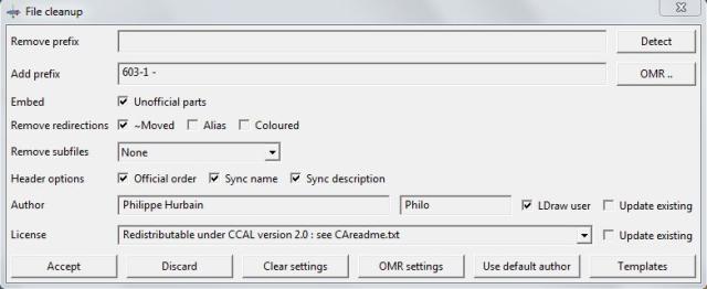

You can "omrize" a file using LDCad : file->cleanup, use these settings (with your name of course Wink )
File name and parts look OK to me. -1 on set number is most often not needed, but here since there are three "603" sets, it is required.
