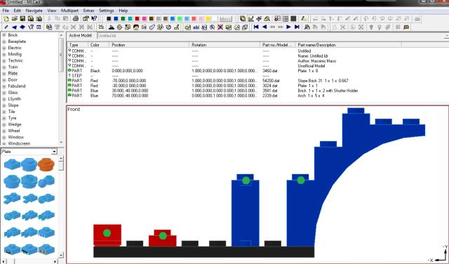

Proposal to change points of origin - Massimo Maso - 2014-03-30 Hello to all, I would like to suggest you the modifcation of the points of origin (or insertion) of parts with multiple horizontal floor or slope. In Annex I report the current situation for two parts of this kind with respect to two normal parts (actual.jpg) and where it would be, for me, more convenient to move the origin point (proposal.jpg). The green points represent the points of origin of the parts, in the top you can see the list of parts (with their position) in both cases. Currently, for parts with more coupling planes, there is chosen as the reference plane the highest plane. For some parts of the slope, which does not expect to have pieces on himself, it is chosen as the origin the plan to which they support, while for others the highest floor, as if they were bricks of standard height. This modification would allow you to use a simple sort function to sort the parts of a model from the bottom up, without having to re-check that the parts are in the right order for a real coupling. I can imagine that it is a long job to find and change all the parts that require it, but then you would have the advantage of finding any alignment issues since only text files, without graphing. At the end, I report a partial list of items that would be subject to change. I am not aware of rules in the implementation of the parts against my proposal. Massimo Parts with multiple floor: 2339 - Arch 1 x 5 x 4 2399 - Wedge 3 x 4 4856 - Wedge 6 x 4 inverted 4865 - Panel 1 x 2 x 1 (both version a adn b and derivated like 4865d01, 4865d02, 4865p06 and 4865p18) 6055 - Panel wall 6 x 6 x 6 corner 6060 - Arch 1 x 6 x 3 & 1/3 with curved top 6066 - Brick 4 x 8 x 2.333 turret top 6072 - Brick 7 x 7 x 2.333 turret quarter 6081 - Brick 2 x 4 x 1 & 1/3 with curved top 6082 - Panel 4 x 10 x 6 rock rectangular 6091 - Brick 2 x 1 x 1 & 1/3 with curved top 6108 - Arch 1 x 12 x 3 6231 - Panel 1 x 1 x corner with rounded corners 13965 - Arch 1 x 3 x 3 30099 - Arch 1 x 5 x 4 inverted 30116 - Panel 14 x 14 x 2.667 quarter saucer top (and derivated like 30116ps0, 30116p6u and 30116p6v) 30117 - Panel 10 x 10 x 2.333 quarter saucer top (and derivated like 30117p6u and 30117p6v) 30201 - Panel 10 x 10 x 2.333 corner base 30272 - Arch 2 x 12 x 6 with grooves 30274 - Brick 2 x 3 x 3 with lion's head carving and cutout 30413 - Panel 1 x 4 x 1 with rounded corners 30613 - Arch 3 x 6 x 5 41761 - Wedge 6 x 8 x 2 triple inverted 42021 - Wedge 6 x 8 x 2 triple inverted (and derivated like 42021d01) 43713 - Wedge 6 x 4 tripple curved inverted 48490 - Panel wall 3 x 8 x 6 50373 - Wedge 3 x 4 with stud notches 76768 - Zrch 1 x 5 x 4 with reinforced tip 87611 - Plane bottom 6 x 10 x 1 87615 - Plane top 6 x 10 x 1 87616 - Plane rear 6 x 10 x 4 88292 - Arch 1 x 3 x 2 93095 - Panel 1 x 2 x 1 with thin central divider and rounded corners 91501 - Panel 2 x 2 x 1 corner with rounded corners Parts slope 2875 - Slope brick 45 2 x 6 x 0.667 3299 - Slope brick 33 2 x 4 double 3300 - Slope brick 33 2 x 2 double 4515 - Slope brick 10 6 x 8 (and derivated like 4515p02 and 4515p03) 4854 - Slope brick 45 4 x 4 double inverted with open center 4871 - Slope brick 45 4 x 2 double inverted with open center 6191 - Brick 1 x 4 x 1 & 1/3 with curved top 6192 - Brick 2 x 4 with curved top 11477 - Slope brick curved 2 x 1 15068 - Slope brick curved 2 x 2 x 0.667 (and derivated like 15068p01) 52501 - Slope bricj 45 6 x 1 double inverted with open center 54200 - Slope brick 31 1 x 1 x 0.667 61068 - Slope brick curved 2 x 4 without underside studs (and derivated like 61068p01) 72454 - Slope brick 45 4 x 4 double inverted with center holes 85984 - Slope brick 31 1 x 2 x 0.667 88930 - Sloep brick curved 2 x 4 with underside studs (and derivated like 88930p01) 93273 - Slope brick curved 4 x 1 double (and derivated like 93273pk0) Re: Proposal to change points of origin - Santeri Piippo - 2014-03-30 The broken origins are retained out of backwards-compatibility. If the origins are just shifted, all existing models using these parts will break. There's the rare exception when a part like this is renumbered and the moved-to file allows a one-time opportunity to fix the origin. Otherwise it's pretty much no-go. Re: Proposal to change points of origin - Willy Tschager - 2014-03-31 There is nothing to add. w. Re: Proposal to change points of origin - Ben Supnik - 2014-03-31 If there is a meta-point on a part that you need noted that is not covered by the origin, you could propose new meta command to annotate points of interest on a part; MLCad's unofficial ROTATION CENTER meta is, I think, an example of this. People seem pretty resistant to adding new meta-commands though. Re: Proposal to change points of origin - Travis Cobbs - 2014-03-31 If there are a lot of parts in the official library with a bad origin, then I think having some kind of insertion point meta-command would make sense. I could even see allowing a single part to have multiple insertion point meta-statements, where the first one would be the most basic one, but others might also be useful, depending on the context in which the part is used. CAD software that supports the insertion point meta-command could either ignore the alternate ones, or provides some way of cycling between them. (Note: I say insertion point, but the meta-command would have to include both translation and rotation information.) If people like Roland and Allen are willing to add support for such a meta-command, I personally would be happy to hash it out with the LSC. Re: Proposal to change points of origin - Steffen - 2014-04-01 I'm not too confident about the concept of such insertion points. The reason is that these insertion points are a sub-concept of the more generic connectivity meta-info being already discussed in a separate thread. Re: Proposal to change points of origin - Ben Supnik - 2014-04-02 Hi Steffen, I agree, re: insertion points - the "related part" dictionary (in the next BrickSmith release when it ships) solves this by providing the relative relationships for _pairs_ of parts...this is more useful than a set of insertion points because BrickSmith knows which one you need for a new insertion based on the current selection. I find the rotation center meta to be useful because some parts have natural rotation but aren't naturally centered around the rotation axis - for example, 1x2 hinges. (A fully general connectivity scheme would 'solve' this, but fully general connectivity is a lot more expensive to implement than a meta command that provides the natural rotation point.) But my meta-point here is that we can add additional point data, and whether it's a good idea depends on the meaning of the data being captured and perhaps its intended use. cheers Ben |
