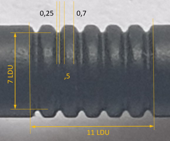

RE: Existing Part Edit Requests - Gerald Lasser - 2019-07-08
Here's a hi-res picture of the part. It'S more a trapezoid shape. I also don't like too sharp edges, but using tori here would give us a LOT of quads...
I go ahead with those measurements, the indents will be shallower then as I used 1 LDU in the mock-up vs. 0,5 I get from the picture

RE: Existing Part Edit Requests - Philippe Hurbain - 2019-07-08
(2019-07-08, 6:42)Gerald Lasser Wrote: Here's a hi-res picture of the part. It'S more a trapezoid shape. I also don't like too sharp edges, but using tori here would give us a LOT of quads...
I'd clearly go with the trapezium method, like s\604547s01.dat with the right ridge scaling. More is pure overkill at this scale.
@all, thanks for your opinions, I go ahead with this one
(2019-07-08, 8:58)Gerald Lasser Wrote: @all, thanks for your opinions, I go ahead with this one
Imho, bottom of grooves cylis are just wasting triangles (though you caould use a single cyli for whole length...)

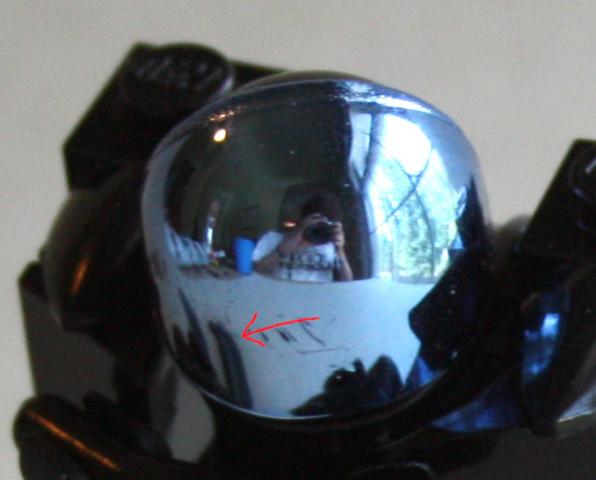

Hi, I'm new here, so if this is the wrong spot for this, just say so.
The Chrome Visor piece (part 769, https://library.ldraw.org/official/12552) has "incorrect" perfectly straight geometry on its lower half, which causes any rendered reflections to be stretched, as shown here:
https://www.flickr.com/photos/thebrickccentric/53497541138
However, the real-life piece is rounded all the way down, resulting in natural-looking reflections, as shown here:
https://www.flickr.com/photos/ironbricks/6008252805
It would be nice if the 3D model could be fixed to match the real piece by adding just a bit more curvature and more triangles on the lower half of the visor. Kind of the entire reason this piece exists is because of its crisp, shiny reflections, so I think fixing this aspect of the piece should be somewhat of a priority.
I have created a very rough fix in Maya, demonstrating that this is possible (it still has some stretching on the bottom though, since my 3D modelling skills are severely lacking):
https://www.flickr.com/photos/thebrickccentric/53498379547
But it would be amazing if someone who actually knows what they are doing could take a shot at fixing this.

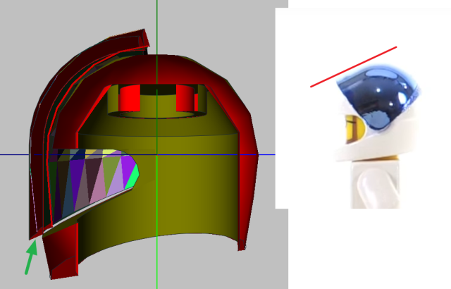

RE: Existing Part Edit Requests - Magnus Forsberg - 2024-01-31
I would say it is flat, but the geometry could be improved. The angle of the bottom front surface is not right.
The green arrow show that the surface in a fresh download of part 23318 is more tilted.
This could be fixed, but not until someone decide to also correct the bad shape on helmet 2446.
https://forums.ldraw.org/thread-26653-post-47475.html#pid47475
RE: Existing Part Edit Requests - Travis Cobbs - 2024-01-31
(2024-01-31, 22:05)Magnus Forsberg Wrote: I would say it is flat, but the geometry could be improved. The angle of the bottom front surface is not right.
While the rendering looks wrong, I don't think it's due to incorrect LDraw part geometry. As Magnus points out, the real helmet really isn't flat, and I'm pretty sure this is visible in your photo:
The red arrow I added certainly appears to point at the spot on the helmet where it changes from spherical to cylindrical. Notice how the apparently linear features in the reflection change direction at that spot.
RE: Existing Part Edit Requests - Grey - 2024-02-01
Thanks for responding! I think you're right and it definitely looks somewhat flat in real life.
From what I understand, it's more of an issue with the seam in the reflection that is present due to the 3D geometry abruptly switching from spherical to cylindrical. (Here's the best explanation I can find of what causes the seam in the reflection:
https://www.youtube.com/watch?v=jvPPXbo87ds&t=1736s
it's talking about flat planes, but if I understand correctly, it should also apply to this piece, where a sphere transitions to a cylinder.)
That's why I was wondering if this piece could get even just the slightest bit of curvature on its lower half---it wouldn't take away all the stretching, but it would smooth it out and make it more like its real-life counterpart.
Also that's kind of crazy how much is left to fix on the helmet model, I had no idea...

RE: Existing Part Edit Requests - SNIPE - 2025-12-03
Hi,
Some of the axles no loner have snapping after they were updated to have rounded ends.
Also some have rounded ends when they should still have square ends, Here is one example:
https://library.ldraw.org/parts/5643
also the old 5.5L axle is slightly shorter than the newer mold.
And probably the axle for small linear actuators and the micro pullback motor brick
This image should help, The left end of the bottom axle is less rounded off.
[Image: 400x200.jpg]
