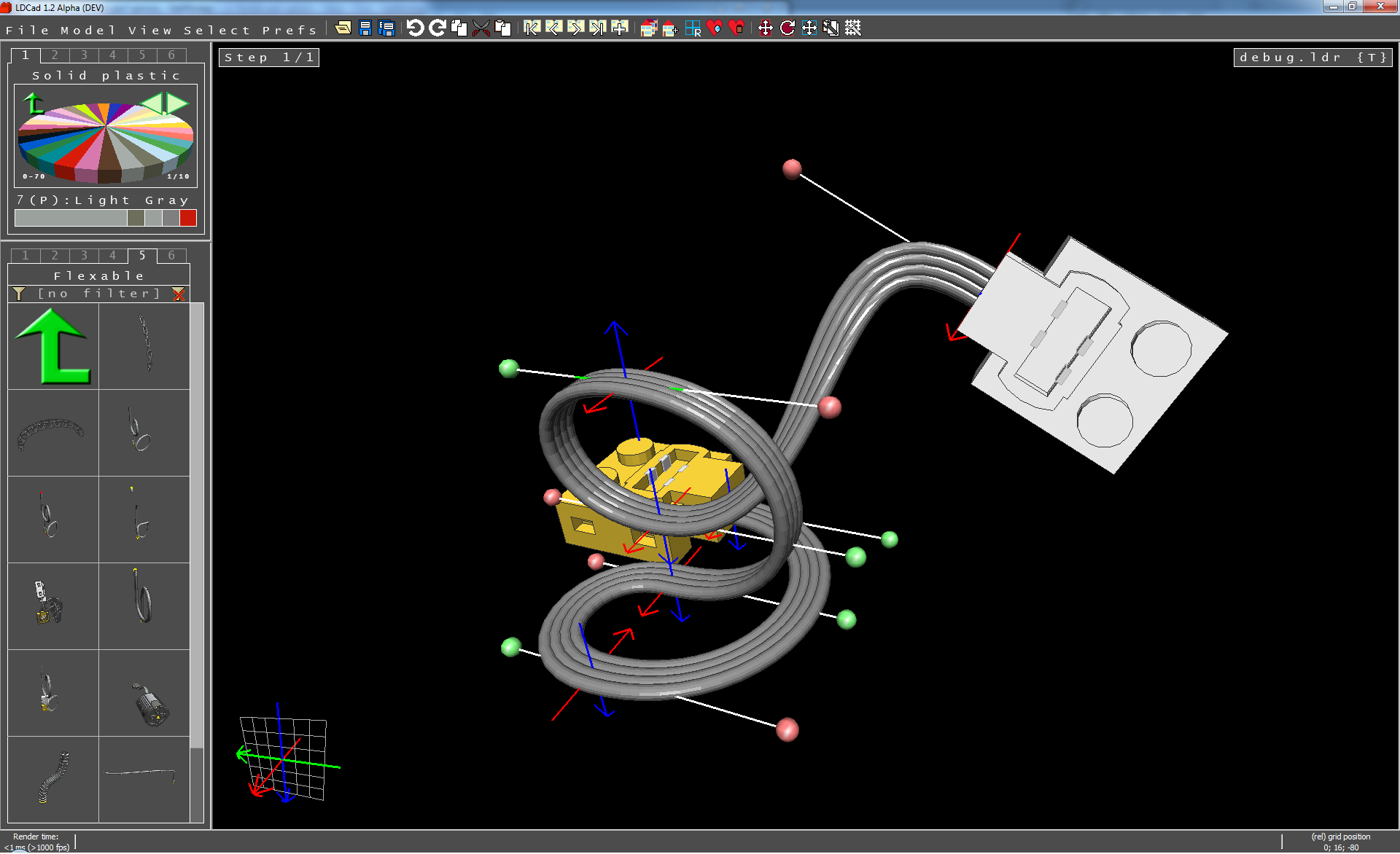

Do you mean higher order bezier curves? I don't think that's necessary (although my bezier class supports it) if you need more curvyness just add path points like so:
[Image: pathPreview.png]
