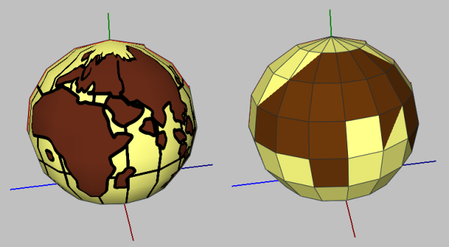

(2022-09-01, 19:48)Orion Pobursky Wrote: ...., then maybe we should define some minimum picture resolution. Basically I'm wondering if we should to set some sort of formal standard for pattern resolution while TEXMAP parts are still few in number.
When I made the globe I also played around with a rudimentary fallback pattern.
In order to keep a good surface for the texmap, there needs to be a good match between triangles and condlines.
A pattern line across a condline will result in a non-smooth surface and a bad surface for the texmap.
.dat   61287p01_patt.dat (Size: 15.87 KB / Downloads: 1)
Reply

RE: TEXMAP Fallback
#10
(2022-09-01, 20:19)Magnus Forsberg Wrote: In order to keep a good surface for the texmap, there needs to be a good match between triangles and condlines.
That's only true if you don't use texture-specific geometry, and don't have an actual FALLBACK section in the TEXMAP section. When the vector geometry is complicated, it belongs in a FALLBACK section that doesn't get rendered at all when TEXMAP is enabled. The geometry that gets textured would then be done via 0 !: lines.
