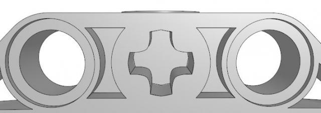

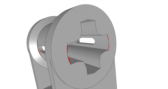

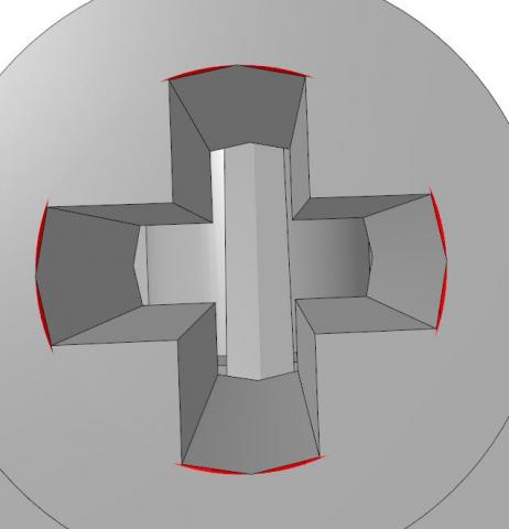

Recently I have noticed that some axle primitives are incompatible with HD circular primitives. On almost any model using axle primitives have holes show up in some places. Probably, we can introduce series of HD axle primitives that would match the HD circular primitives?

(2022-03-23, 14:26)N. W. Perry Wrote: do the vertices of an axle prim match up with the 1/48th sectors?
No, they don't (except for the 4 that match with circular primitives of any resolution).
Btw, I have made set of the high-res axle primitives that fit the high-res circular primitives. Not much would need to be polished about these if it would be decided to add high-res primitives (would be mostly naming and some other minor stuff, like conlines on axlehol8). This includes not all axle primitives, but it's enough for demo of making high-res axle ones is enough for fix of the problem:

Since axleholes are standardized, it would be my expectation for programs that do implement primitive substitution to automatically smooth these primitives to match the cylinder resolution they are substituting to. I believe LDView already does this, Studio probably not. We have added the ering primitives to allow for smooth substitution in those cases where quad/triangle geometry meets round primitives, for the most part proper smoothing and primitive substitution is up to the program developers and is not something we cater to in the library.

(2022-03-23, 7:43)Max Murtazin Wrote: Recently I have noticed that some axle primitives are incompatible with HD circular primitives. On almost any model using axle primitives have holes show up in some places. Probably, we can introduce series of HD axle primitives that would match the HD circular primitives?
All of the updated axlehole primitives include the ering primitive. You need to update your library.
The part in your image is clearly using the old design. What part is it?

It is a part I'm currently working on making. I did update to newer axlehole primitives, but with them some models still had holes. Can't say which ones now, away from my pc

Here, part 6536 still has holes:
