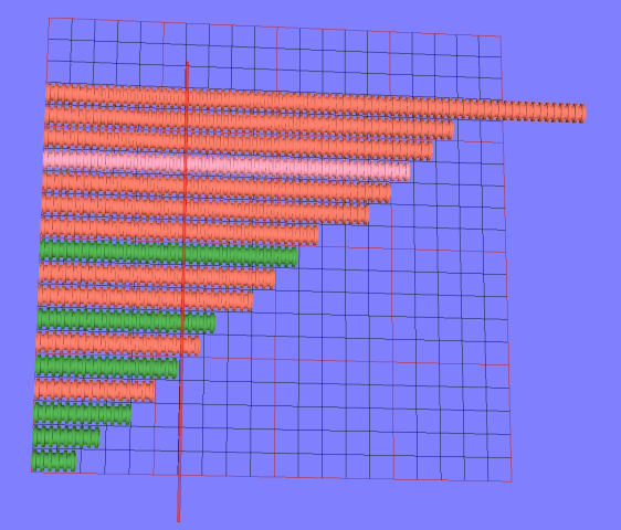

All ribbed hoses 7mm D. ?
#22
Why does the pink hose (71947) deviate from the other hoses?
.png   Image 1.png (Size: 170.16 KB / Downloads: 11)
Attached Files Thumbnail(s)
.dat   ribbed hoses.dat (Size: 1.48 KB / Downloads: 1)
Reply
Re: All ribbed hoses 7mm D. ?
#23
In order to match counted number of ribs and theoretical length I had to adjust pitch on this one. As said, there are lots of discrepancy between similar parts...
Reply

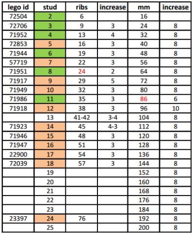

#24
Good.
The pink hose in the example is now corrected, but I have found more deviations in this set of hoses.
Have a look in this chart. (green parts are official)
Two official hoses are wrong
The Keywords info is wrong in 71986. It should be 88mm long, since every hose gets 8 mm longer.
And the hose 71951 should have another rib. Every hose I have counted has 25 ribs, not 24.
I'll fix them.
Reply
#25
After all three deviating parts are corrected, the image now looks like this.
Green hoses are official parts.
Salmon hoses are the new hoses uploaded by Philo.
Yellow hose is adjusted to correct number of ribs.
Blue hoses are corrected and recycled at the PT.
