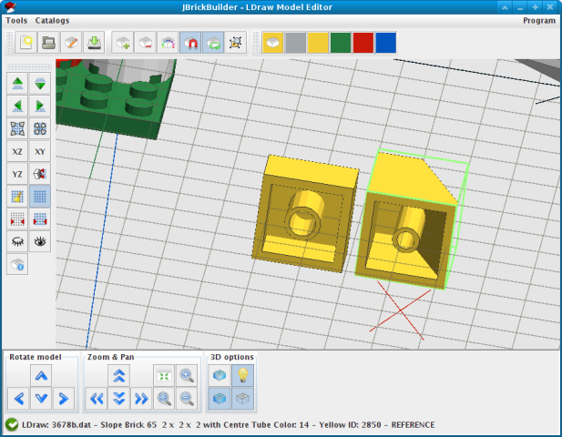

Hi all.
Part 3678b.dat "Slope Brick 65 2 x 2 x 2 with Centre Tube" uses wrong "tube" on bottom.
Tube using "stud2a.dat" but its size is wrong (should be "stud4a.dat"?). Checked on Bricklink, LDD and LDraw editor (no check in real part, I don't have one).
Attached screenshot file shows 3678b (right, with green selection box) and 3003 (left) to compare underside tubes.
Mario

Re: Official parts with errors/typos
#3
Thanks for spotting this. I'll check this evening.
/Max
Reply
#4
Part is corrected. and sent to our admin. He will load it to the PT... It is on PT...
/Max

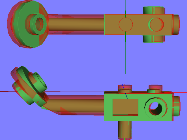

Hi all.
While building this, I noticed that metal detector (part #4479.dat) bar seems too large. Part file reports scale of 6 but I think correct value is 4.
Mario
Reply
#7
Yes, it is wrong. And a comparition with LDD data reveals even more issues.
This part is currently present at the PT, so these issues can be fixed now.
trans-red is ldraw. green is LDD
Reply
RE: Official parts with errors/typos
#24
A new and reworked version of 4479 is now present at the PT as 4479a.dat

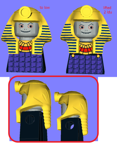

#15
The headdresses 90462 and 30168 are both placed to low. They need to be lifted by 2 ldu.
Best seen from behind. The backside/bottom is placed inside the torso.

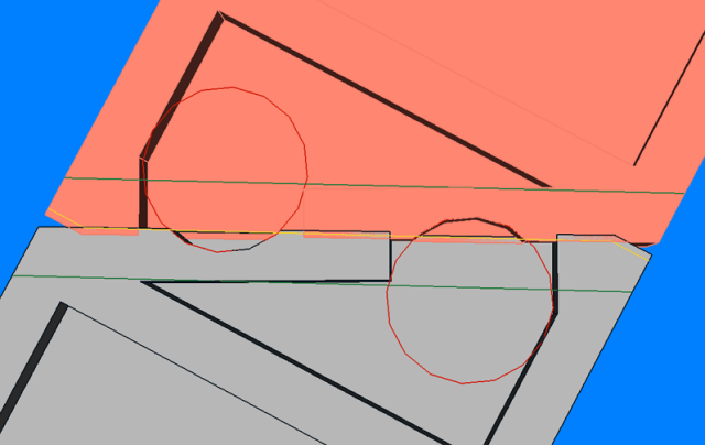

The 2x4 wing 51739 is not correct. It should be possible to place two of them next to each other.
I'm reworking it, and also creating the new 2x2 wing.

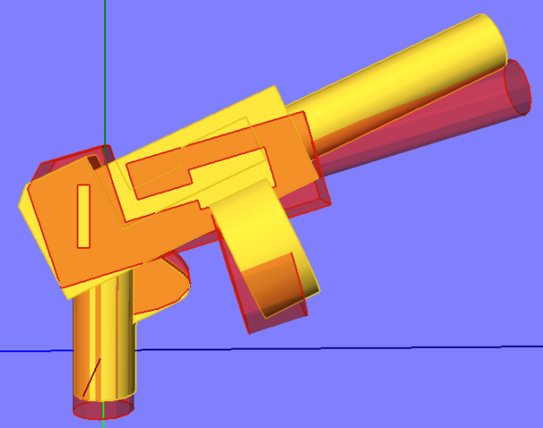

#26
I think the angle of the barrel on the two guns in the batman accessories pack 55707a-55707e are wrong.
.png   Image 1.png (Size: 21.25 KB / Downloads: 30)
TrRed is ldd part 62885. Blue is ldraw part 62885. Yellow is ldraw part 55707a.
TrRed is ldd part 85973. Yellow is ldraw part 55707b.
At Bricklink 62885 is described as similar in mold to bb192 (a part included in 55707, only difference is the length of the barrel)
At Bricklink 85973 is described as similar in mold to x1608 (a part included in 55707)
https://www.bricklink.com/catalogItemInv.asp?P=55707
I don't have any of the 55707 accessories, but I do have the newer parts. I tried to measure the angle of the Tommy gun, and think it should be the same as in ldraw part 62885, 17 degrees. Not 26,81 as in 55707b
