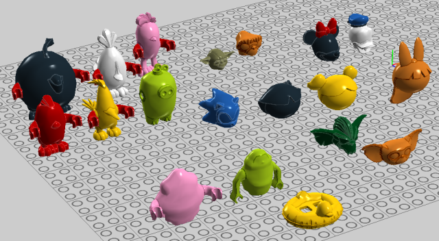

LDD Brickset vs. LDraw Library and Parts Tracker - Rolf Osterthun - 2013-08-22 Hey, there are a lot of LEGO bricks that are available in the LDD, but not in LDraw. I created a list that compares the design-ids known in the LDD Brickset 1128 with the part-numbers that are currently available in the official LDraw Parts Library (up to update 2013-01) and with the part-numbers that are currently on the Parts Tracker (Server time: 2013-08-22 10:11). The LDD uses pure numeric design-ids but LDraw sometimes has numbers with an alphanumeric appendix. To compare these two (three) lists I used the following regular expression: Code: ^<LDDDesignId>([a-zA-Z]+[0-1a-zA-Z]*)*$Since it is possible to convert LDD data to LDraw compatible data, I will gradually provide all parts that have a design-id in the LDD and no matching part-number in the LDraw Universe. Anyway, some of the provided parts might already exist in the LDraw - but I claim that they have a different part-number (we need an alias). Please remember: These are unofficial parts. They may be incomplete, or inaccurate, and it is possible that when they are officially released one day, they may be changed in ways that could mess up any model you use them in. All these parts are redistributable under CCAL version 2.0. Anybody is welcome to use these files to prepare the parts for the LDraw Parts Tracker. I am grateful to any kind of comments, suggestions or hints. Rolf Re: LDD Brickset vs. LDraw Library and Parts Tracker - Fyodor Kolov - 2013-08-23 It's great. Maybe you should add them to the LDraw Parts Tracker, so that others can see them on the tracker and modify them? Re: LDD Brickset vs. LDraw Library and Parts Tracker - Rolf Osterthun - 2013-08-23 Hey Fyodor, all these parts are LDraw compatible but in my mind they are not Parts Tracker worthy. I think there are a few things that should be done at least for each part:
Some of the parts do not match with the reality. Most of the parts do not match with standard LDraw dimensions (e.g. the thickness of plates). So, I think there are many things to be done before these files would flood the Parts Tracker only to receive ‘Hold’ votes. I think that someone who adds a part to the Parts Tracker should have the intention to get it through. Anybody is welcome to prepare these files or use them as a reference. I let myself like disabuse Rolf Re: LDD Brickset vs. LDraw Library and Parts Tracker - Taylor Bangs - 2013-11-30 Not to mention some parts have some detail vertices mis-placed, and this may not be apparent to someone unfamiliar with the part. One that comes to mind would be Furno's original helmet Re: LDD Brickset vs. LDraw Library and Parts Tracker - Joshua Delahunty - 2013-12-08 Rolf Osterthun Wrote:Hey, This is great, Rolf. This can be viewed as continued releases of TLG meshes as we had from the LU project (this would be the very same source material). So these should be treated in the same manner as those files. -- joshua LDD Brickset 1392 vs. LDraw Library 2013-02 and Parts Tracker - Rolf Osterthun - 2014-05-16 Hey, the web-page is updated: LDD Brickset: 1392 LDraw Update: 2013-02 PT Server time: 2014-03-24 10:48:27 Rolf Re: LDD Brickset 1392 vs. LDraw Library 2013-02 and Parts Tracker - Philippe Hurbain - 2014-05-16 Excellent! Any specially noteworthy parts appearing in this release? I haven't had a close look yet... Re: LDD Brickset 1392 vs. LDraw Library 2013-02 and Parts Tracker - Rolf Osterthun - 2014-05-16 Hey Philo, these should be the new parts. Rolf Re: LDD Brickset 1392 vs. LDraw Library 2013-02 and Parts Tracker - Philippe Hurbain - 2014-05-16 Great! Very convenient to browse too. Thanks, Rolf! Re: LDD Brickset 1392 vs. LDraw Library 2013-02 and Parts Tracker - Santeri Piippo - 2014-05-16 I'm currently modeling 44936 (unrelated) but I'd like to reserve 64305 and 64308, I'll model those two. I even happen to have them conveniently sitting on my desk and was contemplating on modeling them the other day.
