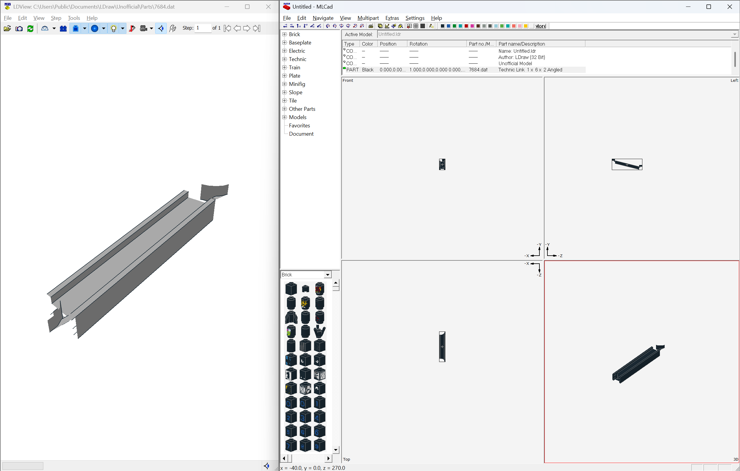

It looks fine on the LDraw website, but when I update my Unofficial parts library, it appears broken in both LDView and MLCad.  I have tried this on multiple Windows 11 amd64) devices.
Screenshot of part 7684 in both apps:
[Image: part_7684.png]
This is not a new issue, I probably noticed it 6 months ago, but was busy and didn't want to file a bug until I had repro'd the issue on a second PC.
---Tom

RE: (unofficial) Part 7684 - broken in both LDView and MLCad - Orion Pobursky - 2026-08-04
What, if anything, does the LDView error window show.
RE: (unofficial) Part 7684 - broken in both LDView and MLCad - Magnus Forsberg - 2026-08-04
It looks like you don't have the correct version of the needed subfile s\64451s01.dat
It has been reworked and is now used in three parts: 64451, 11455, and in the new 7684.

RE: (unofficial) Part 7684 - broken in both LDView and MLCad - Gerald Lasser - 2026-08-04
As the sub-part is an official part (but reworked) LDView is lacking this information.
The part in question and the common sub-part are still unoffical
LDView finds the old sub-part and uses it. It won't update.
RE: (unofficial) Part 7684 - broken in both LDView and MLCad - tom alphin - 2026-08-05
  1. I confirmed that my C:\Users\Public\Documents\LDraw\ folder matched the contents of complete.zip - and it matches exactly.
  2. The next thing I confirmed is that the latest version of 64451s01.dat is in the C:\Users\Public\Documents\LDraw\Unofficial\Parts\s folder - It was correct and up to date.
  3. Next, I manually overrode the version in C:\Users\Public\Documents\LDraw\parts\s to the newer version from the Unofficial folder, but it still did not work correctly.
  4. Finally, I went into MLCad > file > Scan Parts, then added the part to the project file again - and it finally worked as expected in both MLCad and when exported from LDView.
Problem Statement:
LDView and MLCad do not (seem to) use the newer 'p' files from the Unofficial subfolder if that file exists in the official repository.
Potential Fixes:
  1. Modify LDView and MLCad to use the unofficial subparts when they are newer than the official subpart.  (Likely not possible since MLCad is not being updated)
  2. Reference a unique filename when a subpart needs to be modified to support an unofficial part.  ex: 64451s01_unoffical.dat  - This is likely a rare workaround. When part is brought into the official repo, the unofficial reference is removed when the subpart has been updated.

RE: (unofficial) Part 7684 - broken in both LDView and MLCad - Magnus Forsberg - 2026-08-05
(2026-08-05, 3:38)tom alphin Wrote: Problem Statement:
Don't you mean the 's' files?
Somewhere a choice must be made: Should one or the other version of a file with the same name be used?
How does LdView handle that question?
I know from experince that MLCad doesn't handle it correctly. That's one of the reasons I stopped using it.

RE: (unofficial) Part 7684 - broken in both LDView and MLCad - Travis Cobbs - 2026-08-05
(2026-08-05, 13:39)tom alphin Wrote: LDView also handles it incorrectly - see previous photo. It uses the official one, even if a newer s/ file exists in the unofficial folder.
The current LDView behavior is by design, and this case obviously wasn't considered. I'm not sure if I'll try to fix it or not, because fixing it would likely introduce new problems. I believe that you can fix it locally by creating an ldraw.ini file that searches for unofficial parts and primitives before searching for official ones. It should look something like this:
Code:
[LDraw] BaseDirectory=C:\Lars\LDraw [LDrawSearch] 1=<MODELDIR> 2=<UNOFFIC><HIDE><DEFPRIM><LDRAWDIR>\Unofficial\P 3=<UNOFFIC><DEFPART><LDRAWDIR>\Unofficial\PARTS 4=<HIDE><DEFPRIM><LDRAWDIR>\P 5=<DEFPART><LDRAWDIR>\PARTS 6=<LDRAWDIR>\MODELS
Note: The entire [LDraw] section may be optional, but if it's not, BaseDirectory needs to point to your LDraw directory.
I think that the above will only work if you don't have LDView configured to use an LDraw parts zip. Store the above text in a file named ldraw.ini in your LDraw directory.
