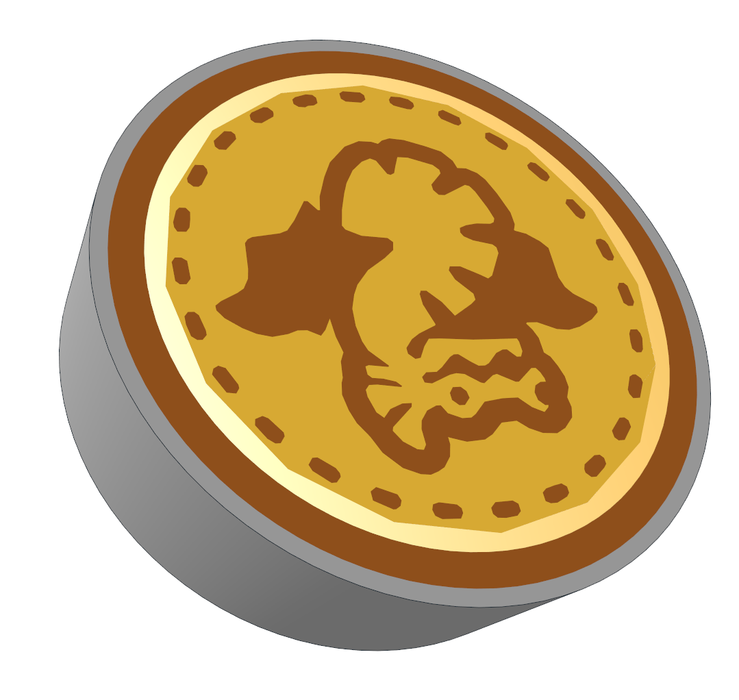

I noticed that the part I was making when I was using a metalic gold ring primative it doesn't get treated the same way as the metalic gold polygons.
Basically the ring primative shows up as metalic in LDView but the polygons don't.
That makes the ring primative very obviously stand out even when both are using the same colour code of 82.
[Image: Screenshot-2026-02-11-141949.png]
So I could not use a ring primative instead but that would just be a workaround.
All the ring primatives in the dat are the same just the colour and size are obvously different
1 16 0 0 0 0.5 0 0 0 1 0 0 0 0.5 4-4ring19.dat
1 484 0 0 0 0.5 0 0 0 1 0 0 0 0.5 4-4ring18.dat
1 484 0 0 0 0.5 0 0 0 1 0 0 0 0.5 4-4ring17.dat
1 82 0 0 0 0.5 0 0 0 1 0 0 0 0.5 4-4ring16.dat
So I don't see why metalic gold should be any different to the others?  Either nothing should be treated as metal or both primatives and polygons need to be treated as metal not just one of the two since they are all the same colour.

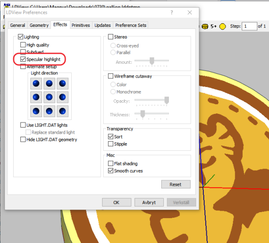

RE: Metalic gold primatives vs polygons rendering issue - Magnus Forsberg - 2026-02-11
Turn off "Specular Highlight"
And a suggestion: Please remove the line
and make the ering prim bigger instead. The gold ring prim only add unnecessary triangles.
RE: Metalic gold primatives vs polygons rendering issue - Peter Grass - 2026-02-11
Specular highlighting though is for anything shiney (ie metal) so the point still stands that anything of colour code 82 should be treated the same way regardless of if its a primative or a triangle / quad.
RE: Metalic gold primatives vs polygons rendering issue - Travis Cobbs - 2026-02-11
(2026-02-11, 16:27)Peter Grass Wrote: Specular highlighting though is for anything shiney (ie metal) so the point still stands that anything of colour code 82 should be treated the same way regardless of if its a primative or a triangle / quad.
Is all the geometry in the middle flat? If so, then I can't think of any reason why the specular highlight wouldn't affect it the same as the ring if it's using the same color code. If it's not flat, then it would get highlighted at different angles.
RE: Metalic gold primatives vs polygons rendering issue - Peter Grass - 2026-02-12
It's all flat. None of the polygons get specular hilighting regardless of the angle.
RE: Metalic gold primatives vs polygons rendering issue - Travis Cobbs - 2026-02-13
(2026-02-12, 19:21)Peter Grass Wrote: It's all flat. None of the polygons get specular hilighting regardless of the angle.
Is the BFC information correct? If you turn on green front faces in LDView, are all the faces green? Also, can you send me the part?
RE: Metalic gold primatives vs polygons rendering issue - Peter Grass - 2026-02-15
(2026-02-13, 0:09)Travis Cobbs Wrote: Is the BFC information correct? If you turn on green front faces in LDView, are all the faces green? Also, can you send me the part?
The part is attached above in the first post, BFC is green in ldview, but only if you turn off the specular highlighting otherwise the gold ring is not green due to that effect being applied to the ring. All parts are green in ldparteditor.
