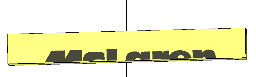

So if for example I wanted to do the texture for 4162pb300 it would look something like this:
0
0 Name: 4162pb300.dat
0 Author:
1 16 0 0 0 1 0 0 0 1 0 0 0 1 s\4162s01.dat
0 !: 4 16 80 0 10 -80 0 10 -80 0 -10 80 0 -10
0 !TEXMAP END
And you end up with this:
[Image: Screenshot-2026-01-14-080501.png]
