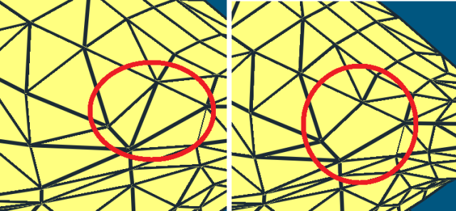

RE: patterned parts - Peter Blomberg - 2025-11-10
(2025-11-10, 16:41)Manfred Schaefer Wrote: Do you have a visual example where a model with a pattern would require an additional conditional line that is not present in the model without a pattern?
https://library.ldraw.org/parts/44236
RE: patterned parts - Chris Böhnke - 2025-11-10
Odd.
Is there an additional one on the pattern - but on the actually unpatterned sub-file?
RE: patterned parts - Orion Pobursky - 2025-11-10
Aside from the face's now being broken up into several colored parts, there should be no difference in the geometry between a patterned part and it's unpatterned version. If that's not the case, it is an error.
