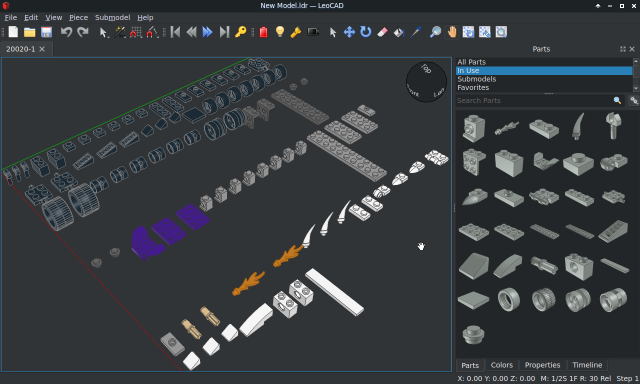

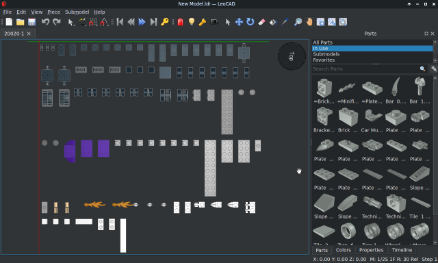

Idea for LUA script to create a knolling layout - Jaco van der Molen - 2024-10-11 Hi all, A question came up about creating a nice and satisfying knolled layout for a model. This can now be done in LDPub3D, but the output is either a PDF page or PNG images showing the knolled BOM of a model. If we want this in an LDraw file, we could be able to do this in a LUA script in LDCad. There are a few sample scripts that take the bricks of a model and reorder them. I was thinking about what if we can make something like the Selection Circle script does. I am slowly learning (self taught) LUA and am trying to modify the Selection Circle myself. But this is complex. Maybe a LUA wizard or programmer can shine a light on this? The steps involved, I think, would be something like this:
Am I on the right track? Is it too complex or can it be done in other ways? LMKWYT RE: Idea for LUA script to create a knolling layout - Fredrik Hareide - 2024-10-11 Hi! I think this is a really interesting idea. I would love to help make this at some point but I do not have a lot of time on my hands right now. I did however try our latest helper (AI) to see if we could get a working prototype to work from. It actually worked fairly well. This script can layout all selected parts but it does not do it in nested mode and it does not reset rotation. With some work that should be possible to change. I must admit that for small stuff like this AI is pretty cool. Code: -- Function to get the X, Y (min), and Z dimensions of a subfile using its bounding box
function getSubfileDimensions(subfile)
local minVec = subfile:getBoundingBoxMin()
local maxVec = subfile:getBoundingBoxMax()
return maxVec:getX() - minVec:getX(), minVec:getY(), maxVec:getZ() - minVec:getZ() -- Return width, minY, and depth
end
-- Function to sort subfiles by their combined XY size
function sortSubfilesBySizeXY(a, b)
local widthA, depthA = getSubfileDimensions(a)
local widthB, depthB = getSubfileDimensions(b)
local sizeA = widthA * depthA
local sizeB = widthB * depthB
return sizeA < sizeB
end
-- Function to layout parts in a knolling grid arrangement on the XY plane
function knollingLayout()
local ses = ldc.session()
if not ses:isLinked() then
ldc.dialog.runMessage('No active model.')
return
end
local sel = ses:getSelection()
local cnt = sel:getRefCount()
if cnt < 2 then
ldc.dialog.runMessage('At least two items should be selected.')
return
end
local subfiles = {}
-- Collect all subfiles (Parts in the selection)
for i = 1, cnt do
table.insert(subfiles, sel:getRef(i))
end
-- Sort subfiles by size (combined X and Z dimensions)
table.sort(subfiles, function(a, b)
return sortSubfilesBySizeXY(a:getSubfile(), b:getSubfile())
end)
-- Determine grid dimensions and spacing
local gridSize = 20 -- Minimum grid size, consider part size + desired spacing
local xOffset = 0
local zOffset = 0
local rowWidth = 0
for i, part in ipairs(subfiles) do
local subfile = part:getSubfile()
local width, minY, depth = getSubfileDimensions(subfile) -- X and Z dimensions, and minY for the Y position
-- Set the part's position
local pos = ldc.vector(xOffset, minY, zOffset)
part:setPos(pos)
-- Update offset for next part
zOffset = zOffset + depth + gridSize -- Move right to the next column
-- Keep track of the maximum width in the current row
rowWidth= math.max(rowWidth, width + gridSize)
-- Check if we need to start a new row
if zOffset + depth > gridSize * 100 then -- Assuming grid is 10 columns wide
xOffset = xOffset + rowWidth
zOffset = 0 -- Move down to the next row
rowWidth = 0 -- Reset row width for the new row
end
end
end
-- Register the macro for the knolling layout
function register()
local macro_lo = ldc.macro('Perform knolling layout')
macro_lo:setHint('Arrange elements in a knolling layout based on size in XY plane with Z = 0.')
macro_lo:setEvent('run', 'knollingLayout')
end
register()RE: Idea for LUA script to create a knolling layout - Fredrik Hareide - 2024-10-11 5541 result. Not great but it's doing something

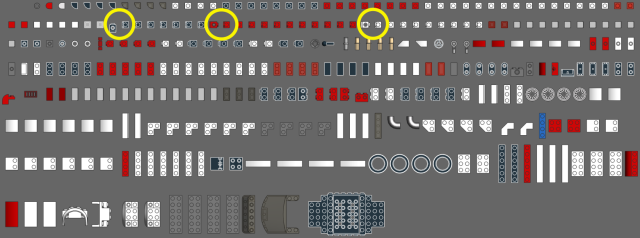

RE: Idea for LUA script to create a knolling layout - Fredrik Hareide - 2024-10-11 I made some adjustments to the script to reset rotation and prepare for inlining. I'm not sure how to inline in LDCad script so here I might need Roland. But if you inline before running it it's starting to look like something Code: -- Function to get the X, Y (min), and Z dimensions of a subfile using its bounding box
end
-- Function to sort subfiles by their combined XZ size
function sortSubfilesBySizeXZ(a, b)
local widthA, _, depthA = getSubfileDimensions(a)
local widthB, _, depthB = getSubfileDimensions(b)
end
-- Function to reset the rotation of a part to identity
function resetPartRotation(part)
local identityMatrix = ldc.matrix()
identityMatrix:setIdentity()
part:setOri(identityMatrix)
end
-- Function to check if a part is a submodel and print its name if it is
function checkAndPrintSubmodel(part)
if subfile:isModel() and subfile:getRefCount() > 0 then
-- print("Submodel name: " .. subfile:getFileName())
-- Do stuff here to inline the submodels
end
end
return
end
if cnt < 2 then
return
end
local subfiles = {}
for i = 1, cnt do
local part = sel:getRef(i)
table.insert(subfiles, part)
checkAndPrintSubmodel(part) -- Check and print submodel name if applicable
end
return sortSubfilesBySizeXZ(a:getSubfile(), b:getSubfile())
end)
local xOffset = 0
local zOffset = 0
local rowWidth = 0
-- Reset the part's rotation
part:setPos(pos)
rowWidth = math.max(rowWidth, width + gridSize)
if zOffset + depth > gridSize * 100 then -- Assuming the grid is 10 columns wide
end
end
end
function register()
end

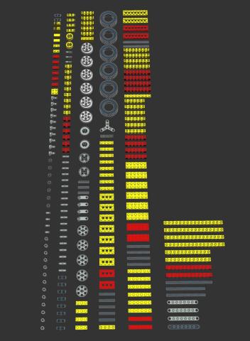

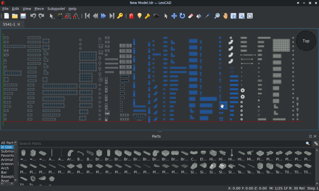

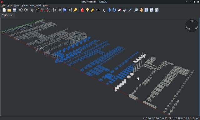

register()RE: Idea for LUA script to create a knolling layout - Jaco van der Molen - 2024-10-11 Nice! I get an error though: Code: [string "knolling.lua"]:3: attempt to call a nil value (method 'getBoundingBoxMin')(I saved this scipt knolling.lua) RE: Idea for LUA script to create a knolling layout - Philippe Hurbain - 2024-10-11 (2024-10-11, 7:48)Jaco van der Molen Wrote: Nice! Do you use 1.7 beta 1? Worked fine here... The "bugs" I noticed are some overlaps (rounded corner plates) and weird height (antennas, heads). Or is is a problem in the bounding box function? RE: Idea for LUA script to create a knolling layout - Fredrik Hareide - 2024-10-11 Yep, I also see the overlapping bugs. Haven't started rewriting the entire code manually yet. So might be an issue with the bb handling yes. I think every row and column need to find out the widest and deepest element and make that the amount to move. Or maybe it's better to avoid the grid logic and just pack everything more dense. That might be better RE: Idea for LUA script to create a knolling layout - Jaco van der Molen - 2024-10-11 (2024-10-11, 8:10)Philippe Hurbain Wrote: Do you use 1.7 beta 1? Oops, my bad. I work on more PC's / Laptops and noticed I used 1.6d ![]() In 1.7b1 works fine and got some nice results too. To enhance this more, perhaps we can take a look at parts that need to rotate 90 degrees like you would knolling in real life with physical bricks, like wheels and tyres. I tested with a model of a car ;-) And what I would love is a sort by part and color! Now it is "just" the order in which the parts are hierarchical in the LDR file. I must say it is very nice to see this fun "feature" is picked up so fast! RE: Idea for LUA script to create a knolling layout - Fredrik Hareide - 2024-10-11 (2024-10-11, 8:37)Jaco van der Molen Wrote: Oops, my bad. I work on more PC's / Laptops and noticed I used 1.6d New version, now with sorting by size, then part, then color. Still needs to make the algorithm rotate the parts so it's lowest profile. So lay down antennas and so on. And also pack it more densly. But it's getting better. Also have some overlaps still Code: -- Setting to determine layout direction ('width' or 'depth')
local layoutDirection = 'depth' -- Change this to 'width' to layout by width
end
-- Function to sort subfiles by their combined XZ size,
-- then by name, and finally by color
function sortSubfiles(a, b)
-- Get dimensions and calculate size
local widthA, _, depthA = getSubfileDimensions(a:getSubfile())
local widthB, _, depthB = getSubfileDimensions(b:getSubfile())
-- Compare by size first
if sizeA ~= sizeB then
end
-- Compare by name if sizes are equal
local nameA = a:getSubfile():getFileName()
local nameB = b:getSubfile():getFileName()
if nameA ~= nameB then
return nameA < nameB
end
-- Compare by color if names are equal
local colorA = a:getColor()
local colorB = b:getColor()
return colorA < colorB
end
end
end
end
-- Function to layout parts densely based on the layout direction
return
end
if cnt < 2 then
return
end
local subfiles = {}
for i = 1, cnt do
end
-- Sort subfiles by size, name, and color
table.sort(subfiles, sortSubfiles)
-- Determine spacing and maximum row/cell size
local spacing = 20
local maxRowSize = 2000 -- Maximum size for a row or column
-- Keep track of the current row's size and maximum dimension height
local currentRowSize = 0
local currentRowMaxDim = 0
local mainOffset = 0
local secondaryOffset = 0
for _, part in ipairs(subfiles) do
local primarySize, secondarySize
if layoutDirection == 'width' then
primarySize = width
secondarySize = depth
else
primarySize = depth
secondarySize = width
end
-- Check if adding this part exceeds the current row's size
if currentRowSize + primarySize + spacing > maxRowSize then
-- Move to the next row or column
mainOffset = 0
secondaryOffset = secondaryOffset + currentRowMaxDim + spacing
currentRowSize = 0
end
local pos
pos = ldc.vector(mainOffset, minY, secondaryOffset)
else
pos = ldc.vector(secondaryOffset, minY, mainOffset)
end
part:setPos(pos)
-- Update offsets for the next item in the current row or column
mainOffset = mainOffset + primarySize + spacing
currentRowSize = currentRowSize + primarySize + spacing
currentRowMaxDim = math.max(currentRowMaxDim, secondarySize + spacing)
end
-- Pack layout more densely
packLayout(subfiles)
end
-- Function to pack the layout more densely
function packLayout(subfiles)
local spacing = 20
primarySize = width
else
primarySize = depth
end
return
end
-- Ask for the target width in LDU
local maxRowSize = tonumber(ldc.dialog.runInput('Target width in LDU (minimum 40)?', '2000'))
if maxRowSize == nil or maxRowSize < 40 then
return
end
local layoutDirection = ldc.dialog.runInput('Layout direction (width or depth)', 'depth')
if layoutDirection == nil or (layoutDirection ~= 'depth' and layoutDirection ~= 'width') then
return
end
local list = {}
local mainSf = ldc.subfile()
buildFlatList(mainSf, ldc.matrix(), list)
deleteAllLines(mainSf)
table.sort(list, sortSubfiles)
local spacing = 20
local newRefs = {}
for _, item in ipairs(list) do
local newRef = mainSf:addNewRef(item.sf:getFileName())
newRef:setColor(item.color)
local width, minY, depth = getSubfileDimensions(item.sf)
primarySize = width
else
primarySize = depth
end
mainOffset = 0
currentRowSize = 0
end
local pos
pos = ldc.vector(mainOffset, 0, secondaryOffset)
else
pos = ldc.vector(secondaryOffset, 0, mainOffset)
end
newRef:setPos(pos)
table.insert(newRefs, newRef)
end
end

register()RE: Idea for LUA script to create a knolling layout - Roland Melkert - 2024-10-20 (2024-10-19, 15:22)Fredrik Hareide Wrote: Still a lot left to do, but this should be better. My 2cts: Instead of deleting the current file you could (optionally) generate a string of new LDraw code and place it on the clipboard. It also gave me the idea to add something to the api to query the open session list in order to let a user choose a target (eg a new model). RE: Idea for LUA script to create a knolling layout - Fredrik Hareide - 2024-10-23 I would be great to have a function in the api to create a new file in a new session. Until that I think I will just keep the overwriting logic. Here is another version. Getting better and better. Now with some filters to rotate some parts. Code: function getSubfileDimensions(subfile)
local width = maxVec:getX() - minVec:getX()
local height = maxVec:getY() - minVec:getY()
local depth = maxVec:getZ() - minVec:getZ()
return width, height, depth, minVec:getX(), minVec:getY(), minVec:getZ(), maxVec:getX(), maxVec:getY(),
maxVec:getZ()
end
function startsWith(str, start)
return string.sub(str, 1, string.len(start)) == start
end
function startsWithAny(str, substrings)
for _, substr in ipairs(substrings) do
if startsWith(str, substr) then
return true
end
end
return false
end
function containsAllWords(str, words)
for _, word in ipairs(words) do
if not string.find(str, word, 1, true) then -- Using plain search
return false
end
end
return true
end
function rotateToSmallestSideUpIfCircle(width, height, depth, minX, minY, minZ, maxX, maxY, maxZ, newRef)
local desc = newRef:getSubfile():getDescription()
local newRefPosOri = ldc.matrix()
local isRotated = false
if startsWithAny(desc, {"Wheel", "Tyre"}) or containsAllWords(desc, {"Technic", "Gear", "Tooth"}) or
containsAllWords(desc, {"Technic", "Wedge", "Belt", "Wheel"}) or startsWith(desc, "Technic Bush") or
startsWith(desc, "Technic Pulley") then
newRefPosOri:setRotate(90, ldc.vector(1, 0, 0))
newRef:setPosOri(newRefPosOri)
-- Swap depth and height
width, height, depth = width, depth, height
minX, minY, minZ, maxX, maxY, maxZ = minX, minZ, minY, maxX, maxZ, maxY
isRotated = true
elseif depth > width then
newRefPosOri:setRotate(90, ldc.vector(0, 1, 0))
-- Swap depth and width
width, height, depth = depth, height, width
minX, minY, minZ, maxX, maxY, maxZ = minZ, minY, minX, maxZ, maxY, maxX
isRotated = true
end
return width, height, depth, minX, minY, minZ, maxX, maxY, maxZ, isRotated
end
function sortSubfiles(a, b, threshold)
local widthA, heightA, depthA, minXA, minYA, minZA, maxXA, maxYA, maxZA = getSubfileDimensions(a.sf)
local widthB, heightB, depthB, minXB, minYB, minZB, maxXB, maxYB, maxZB = getSubfileDimensions(b.sf)
-- Rotate to smallest side up
rotateToSmallestSideUpIfCircle(widthA, heightA, depthA, minXA, minYA, minZA, maxXA, maxYA, maxZA, a.ref)
widthB, depthB, heightB, minXB, minYB, minZB, maxXB, maxYB, maxZB =
rotateToSmallestSideUpIfCircle(widthB, heightB, depthB, minXB, minYB, minZB, maxXB, maxYB, maxZB, b.ref)
-- Determine largest sides after rotation
local largestA = math.max(widthA, heightA, depthA)
local largestB = math.max(widthB, heightB, depthB)
if largestA ~= largestB then
return largestA < largestB
end
-- Fallback to comparing by name if largest sides are equal or thresholds are not met
local nameA = a.sf:getFileName()
local nameB = b.sf:getFileName()
end
-- Finally compare by color if names are also equal
return a.color < b.color
end
function buildFlatList(parentSf, parentPosOri, list)
local cnt = parentSf:getRefCount()
for i = 1, cnt do
local ref = parentSf:getRef(i)
local sf = ref:getSubfile()
local absPosOri = ref:getPosOri() * parentPosOri
if sf:isPart() or sf:isShortCut() then
table.insert(list, {
ref = ref,
color = ref:getColor(),
sf = sf
else
if sf:isGenerated() then
-- collect/map flex info if needed, for now just skip it.
-- print('flex: '..sf:getFileName())
else
buildFlatList(sf, absPosOri, list)
end
end
end
end
function deleteAllLines(mainSf)
for i = mainSf:getLineCount(), 1, -1 do
local line = mainSf:getLine(i)
line:delete()
end
end
function zeroOrValue(val1, val2)
local sum = val1 + val2
if sum == 0 then
return 0
else
return sum
end
end

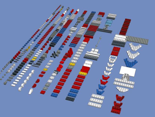

return
end
return
end
return
end
local list = {}
local threshold = 50 -- Set this to your desired threshold value
table.sort(list, function(a, b)
return sortSubfiles(a, b, threshold)
end)
local spacing = 20 -- Adjust spacing if needed
local newRefs = {}
local pivotOffsetZ = 0
local width, height, depth, minX, minY, minZ, maxX, maxY, maxZ = getSubfileDimensions(item.sf)
-- Rotate to smallest side up if the other two sides are equal and get the new center coordinates
width, height, depth, minX, minY, minZ, maxX, maxY, maxZ, isRotated =
local primarySize, secondarySize, primaryMin, secondaryMin
primarySize = width
primaryMin = minX
secondaryMin = minZ
else
primarySize = depth
primaryMin = minZ
secondaryMin = minX
end
mainOffset = 0
currentRowSize = 0
lastMax = 0
end
local yPos = 0
if isRotated and maxY ~= 0 then
yPos = math.min(minY, -maxY)
else
yPos = -maxY
end
local pos
pos = ldc.vector(mainOffset - primaryMin + spacing, yPos, secondaryOffset - secondaryMin + spacing)
else
pos = ldc.vector(secondaryOffset - secondaryMin + spacing, yPos, mainOffset - primaryMin + spacing)
end
newRef:setPos(pos)
end
end
function register()
macro_lo:setHint('Arrange elements densely with even spacing in the XY plane with Z = 0.')
end
register()RE: Idea for LUA script to create a knolling layout - N. W. Perry - 2024-11-14 This could be handy when previewing an LDraw model for use in Studio—spotting missing parts, wrong origins/orientation, etc. What about adding the option to include each part only once (a visual bill of materials, in other words)? |
