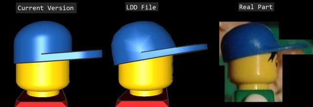

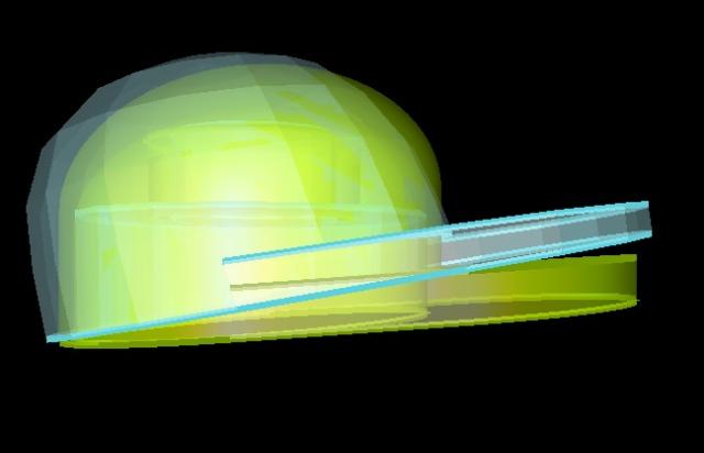

Rework of part 4485 - Chris Böhnke - 2024-09-08 Hello, I wanted to do the patterned versions of the old minifig baseball cap (part 4485), so I looked into the official file to see how it could be sub-filed. While doing this, I discovered a slight difference to the real part regarding the angle of the bill and a few proportion issues. The LDD version seems to be somewhat closer to the real part: Do you think this part should be entirely reworked or should I just try to sub-file the old version for the patterns? I already did a simple clean-up of the LDD part, however there are still a few issues with the stud connector and the question if the top part can or should be replaced with a sphere primitive (it connects to a lot of non-primitive areas so it will probably look odd in some resolutions). RE: Rework of part 4485 - Magnus Forsberg - 2024-09-08 (2024-09-08, 15:50)Chris Böhnke Wrote: Do you think this part should be entirely reworked or should I just try to sub-file the old version for the patterns? I think we should obsolete the old file. It's in need of a complete rework anyway. Don't bother with primitives. The only needed primitive is the understud. And don't divide it. RE: Rework of part 4485 - Chris Böhnke - 2024-09-08 Ok, so naming the new one 4485b.dat is correct? I will rework the understud and put it on the Parts Tracker. I then should submit a 'fix' for the original file to put it to obsolete? RE: Rework of part 4485 - Rene Rechthaler - 2024-09-08 (2024-09-08, 19:07)Magnus Forsberg Wrote: I think we should obsolete the old file. It's in need of a complete rework anyway. dont divide the prim or dont divide the new file? RE: Rework of part 4485 - Orion Pobursky - 2024-09-08 (2024-09-08, 20:13)Chris Böhnke Wrote: Ok, so naming the new one 4485b.dat is correct? Yes, 4485b is correct Yes to the second. Simply put a "~" in front and "(Obsolete)" at the end of the description and add "Obsolete" as the CATEGORY. RE: Rework of part 4485 - Magnus Forsberg - 2024-09-08 (2024-09-08, 21:17)Rene Rechthaler Wrote: dont divide the prim or dont divide the new file? The understud prim. RE: Rework of part 4485 - Chris Böhnke - 2024-09-08 The new version is on the PT. I tried to upload the obsoleted old file, however the PT won't let me upload it, because it's BFC CW. Can I simply correct that and try again or is it more complicated in this case? RE: Rework of part 4485 - Orion Pobursky - 2024-09-08 (2024-09-08, 21:58)Chris Böhnke Wrote: The new version is on the PT. Flip the winding and submit. RE: Rework of part 4485 - Chris Böhnke - 2024-09-08 Done. Thanks at all for the help
