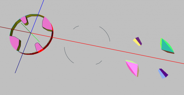

Next update (22-03) - Orion Pobursky - 2022-04-26 It's looking like the next update will happen around the weekend of the 7th. I'd like to have the axle fix finished so that gives us 2 weeks to take care of the items on this list: https://www.ldraw.org/cgi-bin/ptreviewsummary.cgi?f=axleholefix and address any items on the focus list that can be done. Thanks for all the regular part reviewer efforts. RE: Next update (22-03) - Gerald Lasser - 2022-04-26 As there are some chrd and ering prims in the next batch of axleholes, I raised a question there on how to properly fit axleholes. https://forums.ldraw.org/thread-23835-post-45678.html#pid45678 so far Philo has replied, but I think it is something we should consider: a) Not using chrd and ering in the axle prims Let the user of the axlehole decide how to embed it, so the user can choose if it will be embedded in a ndis/ring and add the necessary 4-4ering themselves, or use triangles/quads b) using chrd/ering in the axlehole prims This would imply that an Axlehole is always embedded in a ndis/ring Embedding it in surfaces would lead to overlapping surfaces RE: Next update (22-03) - Willy Tschager - 2022-05-02 (2022-04-26, 21:04)Gerald Wrote: a) Not using chrd and ering in the axle prims +1 I'm not a friend of "invisible" geometry anyway. The hack is intriguing but I'd like to leave it to the user. w. RE: Next update (22-03) - Orion Pobursky - 2022-05-02 (2022-04-26, 21:04)Gerald Lasser Wrote: As there are some chrd and ering prims in the next batch of axleholes, I raised a question there on how to properly fit axleholes. I don't have preference to either option. I will make a decision if consensus isn't reached but I'd rather not have to do that. RE: Next update (22-03) - Philippe Hurbain - 2022-05-02 (2022-04-26, 21:04)Gerald Lasser Wrote: a) Not using chrd and ering in the axle primsAs said previously, I favor the axleholes without chrd/ering as this offers the maximum flexibility. RE: Next update (22-03) - Magnus Forsberg - 2022-05-02 To me, this issue is raised a bit late. I would have to rework all the files using the regular axlehole primitives once again. But that doesn't stop us from changing the axl2hole prims. But it would perhaps hold back the next part release. RE: Next update (22-03) - Orion Pobursky - 2022-05-02 (2022-05-02, 19:17)Magnus Forsberg Wrote: To me, this issue is raised a bit late. Small delay is fine. We can shift 22-03 to the weekend of 5/21. Or I can do 22-03 and hold back the affected parts. RE: Next update (22-03) - Max Martin Richter - 2022-05-03 (2022-05-02, 18:51)Philippe Hurbain Wrote: As said previously, I favor the axleholes without chrd/ering as this offers the maximum flexibility. I would like to see the axlehole prims without the invisible geometry as it can be added to the parent files if needed and give the flexibility to connect the axlehole prims to non curved surfaces without getting overlappings in hi res. RE: Next update (22-03) - Orion Pobursky - 2022-05-03 It looks like the consensus amongst senior reviewers is remove. What's the preference for the update:
RE: Next update (22-03) - Magnus Forsberg - 2022-05-03 (2022-05-03, 14:21)Orion Pobursky Wrote: It looks like the consensus amongst senior reviewers is remove. I'll start working. RE: Next update (22-03) - Magnus Forsberg - 2022-05-03 (2022-05-03, 15:05)Magnus Forsberg Wrote: I'll start working. This will have an effect on three prims, axl2hole, axl2hol3, axl2ho10. Should they all be changed to not use any ering, chrd or edge primitives? RE: Next update (22-03) - Philippe Hurbain - 2022-05-03 (2022-05-03, 15:31)Magnus Forsberg Wrote: This will have an effect on three prims, axl2hole, axl2hol3, axl2ho10.I would remove erings and chrds. But edge prims are more questionnable. I think I'd keep them since they are supposed to match cylinders. RE: Next update (22-03) - Max Martin Richter - 2022-05-03 (2022-05-03, 14:21)Orion Pobursky Wrote: It looks like the consensus amongst senior reviewers is remove. I vote for your 2nd suggestion. RE: Next update (22-03) - Max Martin Richter - 2022-05-03 (2022-05-03, 15:31)Magnus Forsberg Wrote: Should they all be changed to not use any ering, chrd or edge primitives? Yes, remove erings and chrds but let the edges there. RE: Next update (22-03) - Magnus Forsberg - 2022-05-03 3 primitives and 2+13 subfiles and files are now updated, and no longer adapt to hi-res. Please give them a review https://www.ldraw.org/cgi-bin/ptreviewsummary.cgi?f=axleholefix RE: Next update (22-03) - Orion Pobursky - 2022-05-03 (2022-05-03, 20:48)Magnus Forsberg Wrote: 3 primitives and 2+13 subfiles and files are now updated, and no longer adapt to hi-res. Much thanks for your quick work Magnus. RE: Next update (22-03) - Gerald Lasser - 2022-05-03 (2022-05-03, 20:48)Magnus Forsberg Wrote: 3 primitives and 2+13 subfiles and files are now updated, and no longer adapt to hi-res. Thanks a lot! RE: Next update (22-03) - Orion Pobursky - 2022-05-06 Thanks to Magnus's quick work, there are 6 files left for the axlehole fix that need more votes. I plan on getting the update done Saturday so let's get these to the finish line (I will delay if that doesn't happen) RE: Next update (22-03) - Orion Pobursky - 2022-05-07 I'd like to see the last 5 parts on the Parts Admin focus list addressed for the update. https://www.ldraw.org/cgi-bin/ptreviewsummary.cgi?f=pafocus |
