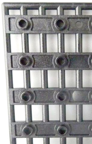

Parts 11216 and 89519 - Massimo Maso - 2020-11-01 I'm starting to work on 11216 and 89519. According to the references I found in digital-bricks.de, the two parts are very similar and there will be some subparts in common. What I'm not sure about is the area below the studs. In one case (89519) the cylinder is connected to the straight part between two little cylinders, in the other (11216) the intersection is direct. I tried to verify this with pictures of the actual components, but couldn't find a good enough one. Can anyone tell me what to do? RE: Parts 11216 and 89519 - Philippe Hurbain - 2020-11-01 (2020-11-01, 9:40)Massimo Maso Wrote: I tried to verify this with pictures of the actual components, but couldn't find a good enough one.This one seems pretty good... https://www.steinpalast.eu/en/1-x-lego-brick-dank-brown-door-1-x-12-x-16-castle-gate-portcullis-set-star-wars-75005-6014226-11216 And a closeup... RE: Parts 11216 and 89519 - Gerald Lasser - 2020-11-01 (2020-11-01, 9:40)Massimo Maso Wrote: I'm starting to work on 11216 and 89519. Got them both, here are some close ups: https://www.dropbox.com/sh/c2bxznmnqyqcmdm/AACBXKmJNi9Oupwo4SWbt-yCa?dl=0 |
