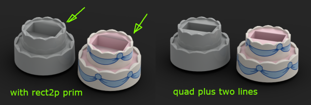

I uploaded the cake costume parts, 35860 and 38560p01, and had them rendered in Stud.io.
What I got was an interesting result. on the LEFT the parts are as I have uploaded them to the PT, resulting in this "cond-line artefact". I remembered that I used a rect2p there with a shear matrix. So I in-lined this and I got the result on the RIGHT picture. Seems that the pre-processing for the renderer is not working correctly.
Has anybody noticed this and (re-)designed a part with this problem in mind?
Code:
0 // ORIGINAL CODE (LEFT) 1 16 0 -20 -10.75 19 0 0 0 1 20 0 0 .25 rect2p.dat 1 16 0 -20 10.75 -19 0 0 0 1 20 0 0 -.25 rect2p.dat 0 // INLINED CODE (RIGHT) 2 24 19 0 -10.5 -19 0 -10.5 2 24 -19 -40 -11 19 -40 -11 4 16 -19 0 -10.5 -19 -40 -11 19 -40 -11 19 0 -10.5 2 24 -19 0 10.5 19 0 10.5 2 24 19 -40 11 -19 -40 11 4 16 19 0 10.5 19 -40 11 -19 -40 11 -19 0 10.5
