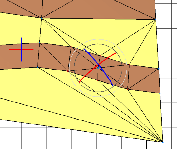

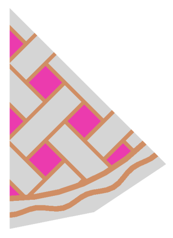

Curved Sine Wave - Vincent Messenet - 2020-05-14 I'm authoring the following pattern: ![]() The part is almost ready except that I'm not satisfied with the curved sine wave on the round border. I'm sure there is a way to do it better using an appropriate tool but I don't know which one. Would you have any suggestions on how to design it? Here are my files so far. RE: Curved Sine Wave - Magnus Forsberg - 2020-05-14 Maybe something like this? Create a centre point. Split the longer sides. "Action/Split N-times" Set the Manipulator on the centre vertex. Select all the vertices around and Rotate the surface. RE: Curved Sine Wave - Gerald Lasser - 2020-05-14 Hi Vincent, here's a small spreadsheet that calculates a sinus wave, unfortunately it is not very flexible, but it might get you the idea I have attached the result as well. Let me know if you want a different amplitude Gerald RE: Curved Sine Wave - Vincent Messenet - 2020-05-15 Thanks to both of you! I like learning new techniques

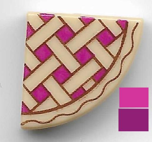

RE: Curved Sine Wave - Willy Tschager - 2020-05-15 Maby something like this: https://www.ldraw.org/cgi-bin/ptdetail.cgi?f=parts/s/u572p02s01.dat w. RE: Curved Sine Wave - Vincent Messenet - 2020-05-15 (2020-05-14, 18:55)Gerald Lasser Wrote: Hi Vincent, Thanks for the spreadsheet, it helps for sure. I found the line too thick so I modified the width to 0.25 and amplitude to 0.375 I will submit this on PT now. RE: Curved Sine Wave - Marc Giraudet - 2020-05-15 Thanks to have authoring this part, I need 2 of it for the set 10255 - Assembly Square. A question about the color choice. How do you choose the right color ? Usually, I use a scanner and a small tool to found the right color. For this part the pink area is closer magenta with this method. RE: Curved Sine Wave - Orion Pobursky - 2020-05-15 (2020-05-15, 6:57)Vincent Messenet Wrote: Thanks to both of you! I like learning new techniques Thanks for authoring this. I've updated my Modular Buildings missing parts list. https://forums.ldraw.org/thread-23992.html RE: Curved Sine Wave - Vincent Messenet - 2020-05-15 (2020-05-15, 12:29)Marc Giraudet Wrote: Thanks to have authoring this part, I need 2 of it for the set 10255 - Assembly Square. To be honest I rely on my sight and I compare Ldraw colors with pattern pictures. But indeed I have some doubts about the colors I used for that part. RE: Curved Sine Wave - Gerald Lasser - 2020-05-15 (2020-05-15, 6:57)Vincent Messenet Wrote: Thanks to both of you! I like learning new techniques It's always good and welcome to exchange ideas! RE: Curved Sine Wave - Marc Giraudet - 2020-05-15 (2020-05-15, 15:39)Vincent Messenet Wrote: To be honest I rely on my sight and I compare Ldraw colors with pattern pictures. I made a second test and I agree your choice, dark pink instead of magenta. |
