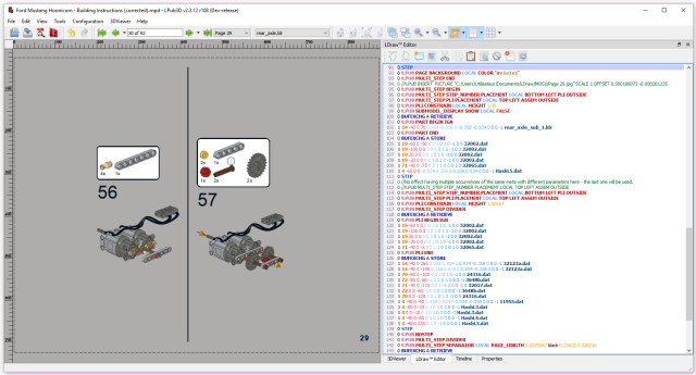

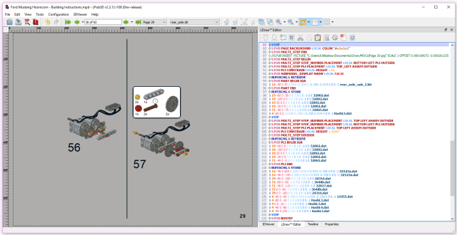

PLI and Step number placement "bug"?
Sometimes it's pretty difficult to place all the elements correctly. I would like to have the step number and the PLI at the top left of the assembly image, with the step number at the left bottom of the PLI. But sometimes there is like a "bug", it's impossible to place all the elements correctly. I have tried different setups, but sometimes, as in the example below, when I want "Step number: Left Bottom of the PLI" it is not placed correctly. How is it possible to fix that?
To have the same positions as in the LEGO manuals, what do I need to place relative to what element, and how?
[Image: 48453850246_f5c2733e80_b.jpg]
In the previous page, it worked as I wanted, and I used this:
Code:
0 !LPUB MULTI_STEP STEP_NUMBER PLACEMENT LOCAL BOTTOM LEFT PLI OUTSIDE 0 !LPUB MULTI_STEP PLI PLACEMENT LOCAL TOP_LEFT ASSEM OUTSIDE
But it doesn't work for the page above when I use the same code.
I have even tried to remove all the LPub commands for that page to restart, but I still don't reach to do as I want...
In other steps, I have done this, and it also worked perfectly:
Code:
0 !LPUB MULTI_STEP STEP_NUMBER PLACEMENT LOCAL TOP_LEFT ASSEM OUTSIDE 0 !LPUB MULTI_STEP PLI PLACEMENT LOCAL BOTTOM LEFT PLI OUTSIDE
But it doesn't work for the step above.

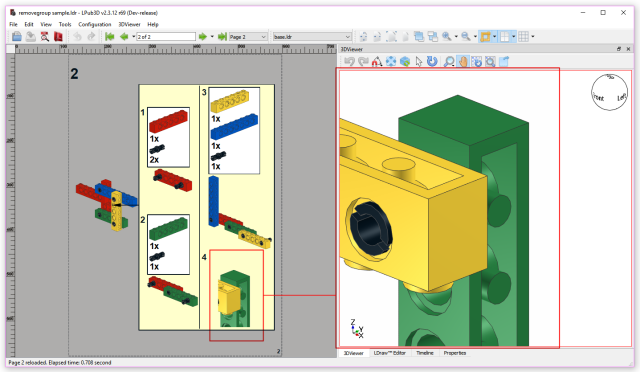

Add captures - Zoom on a part of the model (LPub3D):
I don't know how, but I know it's possible, as in the page 6 you can find in this manual made with LPub3D (Available here - By Trevor Sandy). So I'm asking: how to proceed?
(I'm working with the LDView render and not the Native one)

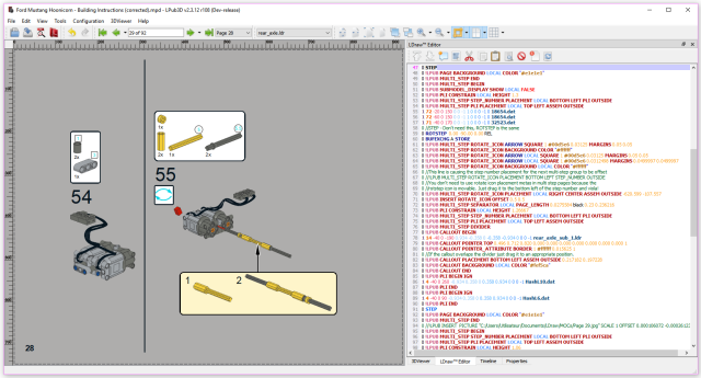

(2019-08-04, 14:51)Anto Wrote: PLI and Step number placement "bug"?
Can you provide a snapshot of the LEGO manual page you are trying to replicate? Also, can you share a sample model file with the steps you intend to configure as described? You can PM the model file if you do not wish to share it publicly.
(2019-08-04, 14:51)Anto Wrote: Is it possible to place all the elements manually on a Multi step page (using a grid to place them easily)?
No. There is no capability that enables this behaviour in LPub3D.
(2019-08-04, 14:51)Anto Wrote: Add captures - Zoom on a part of the model (LPub3D):
This behaviour is not currently possible from the LPub3D user interface. However, I've just finished the preliminary implementation and expect to push it to the DevOps Continuous Build in the next few days.
Upd: There is now the possibility to animate the zoom and look-at settings and save the current step's CSI and Submodel images interactively from the 3DViewer. This behaviour uses the Native renderer exclusively and can be used to update CSI and Submodel preview images. See GitHub ticket #327 for more info.
This updates has been pushed to the DevOps repository and will be available for download if there are no build breaks.

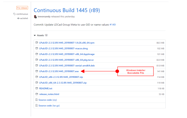

What do I need to download to get the last release (I'm on Windows)? Just the files I want then I have to put them in the good repertories? (I'm a bit lost ^^')

(2019-08-05, 11:39)Anto Wrote: What do I need to download to get the last release (I'm on Windows)? Just the files I want then I have to put them in the good repertories? (I'm a bit lost ^^')
Trevor Wrote:There is a Continuous Build release at the LPub3D production repository. You can download the latest build for Windows (installed and portable distros), Linux AppImage, Ubuntu, Arch, Fedora and macOS platforms.
Click on the embedded link and follow the steps to download and extract (.zip), insall (.exe) your preferred distribution. Note: If a build is in progress, not all distributions will be available. In fact, the Microsoft builds are the last to be produced.

(2019-08-05, 11:39)Anto Wrote: To zoom on a part of the model, ...is it possible to make screenshots and to add pictures in a page to get the same result? (Using LDView)
Yes. However, be advised that taking this approach is a bit advanced. There are several ways to generate images outside of the default page build. If you take a look at the LPub3D log (Help->View LPub3D Log), you can see the exact command passed to the renderer. For LDView, you can use the online user manual to set the precise flags you need to achieve the rendering you want - including changing the look at position of your model (-ModelCenter 0.0,0.0,0.0) and zooming (-ModelSize 0.0). You can also edit the LDView.ini, and many others, file from Configuration->Edit Parameter Files... Use this capability to render a single step or combine all the steps you wish to customize and render accordingly. After that, you can transfer the images to your main project. Keep in mind that if you should ensure the 'Last Update' date on your images is the same or newer than the same setting on your model file. If you make an update to the model file, LPub3D will automatically overwrite the image during the render process. I think with this new information, you can use your insights to create the appropriate environments(s) to get the result you're looking for going forward.

I didn't see the .exe file, so I didn't know which one I had to use. ^^ Now I have installed the last release. (What is the utility of the other files?)

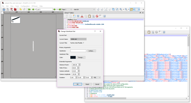

Now I can use the function "substitute", however, when I do right click / substitute on the part I want to change, if it's a sub model (as a flex) the app crashes. But it works perfectly when I use the meta commands, even with sub models.

RE: Some questions about LDCad and LPub3D - Trevor Sandy - 2019-08-08
(2019-08-08, 11:38)Anto Wrote: I didn't see the .exe file, so I didn't know which one I had to use. ^^ Now I have installed the last release. (What is the utility of the other files?)
This is what the Windows installer executable file looks like in the list. It could be easy to miss among the others.
(2019-08-08, 11:38)Anto Wrote: Now I can use the function "substitute", however, when I do right click / substitute on the part I want to change, if it's a sub model (as a flex) the app crashes. But it works perfectly when I use the meta commands, even with sub models.
Hmm, thanks for reporting this behaviour. I'll take a look.
(2019-08-08, 12:18)Trevor Sandy Wrote: Hmm, thanks for reporting this behaviour. I'll take a look.
I am not able to reproduce this behaviour and no one else has reported the same. Here is what I get with the attached LDCad generated flex subfile.
Perhaps there is some nuance I am not replicating. If you want you can share the model file that's producing this behaviour and I'll take a look.

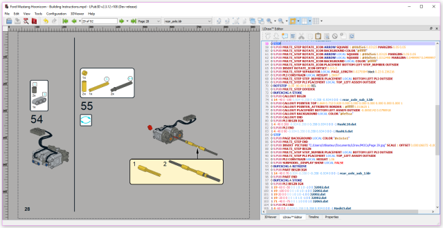

RE: Some questions about LDCad and LPub3D - Trevor Sandy - 2019-08-09
(2019-08-08, 11:38)Anto Wrote: ...I have sent you an e-mail about the placement problem (finally only one page on the whole instructions).
See below the "Before" and "After" meta command corrections. Explanation notes are captured as model file comments.
Before:
After:
Cheers,

About the bug of the substitution of a sub-model, you can try with the file I sent you. Go to the page 85 for example where there is a sub-model of a flex, and try to do Right click / Substitute on the bent flex in the PLI (you can also try with a motor page 2). If you don't have any problem, perhaps it's something wrong with my computer / installation of the software and the LDraw library.
