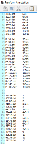

Hi Jaco
I solved the problem with the freeform annotation.
I just added all the parts I wanted to display in the parameter file "Free Form PLI Annotation" and commented out the lines in the "Part Title PLI Annaotation" with #.

(2018-11-07, 17:33)Johann Eisner Wrote: (2018-11-07, 6:54)Jaco van der Molen Wrote: OK, so I got a bit further using this website https://regex101.com/
I got all beams to show just the lengt, but also from those which I do not want, like the liftarms.
Now I have this: ^Technic Beam\s+(\d+\.*\d*)\s*.*$
Any thoughts on how to exclude all modified beams?
Hi Jaco
Ah, yes. I've thought of that too, but seems a lot of work to maintain.
But I could give that some more thought using an Excel sheet or something to fill the file.
Tnx!
RE: Title annotation in LPub3D - Johann Eisner - 2018-11-07
(2018-11-07, 19:02)Jaco van der Molen Wrote: (2018-11-07, 17:33)Johann Eisner Wrote: Hi Jaco
Tnx!
Hi
It's only a bit of work once, but how many parts are there that you want. I already have the beams, the axles are working well original, and maybe a few parts of my own like pneumatic hoses.
RE: Title annotation in LPub3D - Jaco van der Molen - 2018-11-07
(2018-11-07, 19:09)Johann Eisner Wrote: (2018-11-07, 19:02)Jaco van der Molen Wrote: Ah, yes. I've thought of that too, but seems a lot of work to maintain.
Tnx!
Hi
True. I was looking for a more convenient way, but I guess working with Freeform is a better option and in the end faster.
