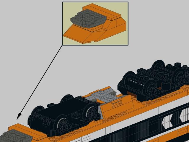

How to back to normal view in LPub created instructions? - Zhengrong Zang - 2014-03-01 I am using LPub with mpd to create instruction, I rotated parent at last step, but even if I insert rotation end or rotated again, the last view in instruction is not back to normal view? Why? How can back to norm view at last? Re: How to back to normal view in LPub created instructions? - Philippe Hurbain - 2014-03-02 LPub doesn't account for step that doesn't contain a part change. To return model to "normal" orientation in the last step, just add a dummy buffer exchange before the rotstep: 0 BUFEXCHG X STORE 0 BUFEXCHG X RETRIEVE Re: How to back to normal view in LPub created instructions? - Zhengrong Zang - 2014-03-02 Philippe Hurbain Wrote:LPub doesn't account for step that doesn't contain a part change. To return model to "normal" orientation in the last step, just add a dummy buffer exchange before the rotstep:Thanks a lot, I got it. |
