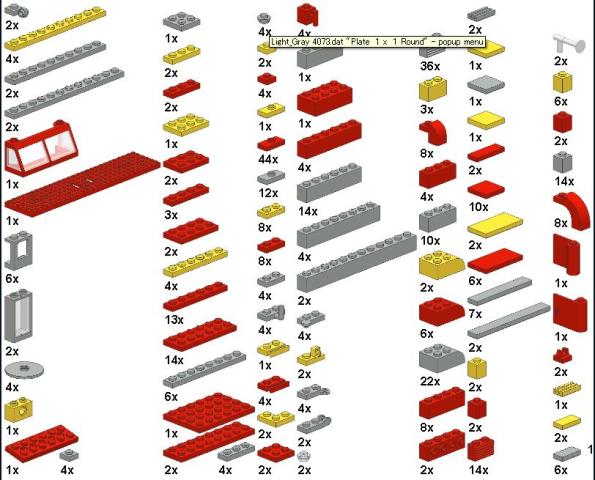

How to create Bill of Materials on two pages? - Zhengrong Zang - 2014-02-03 I am using MLCad to build train with a longer train baseplate. Though I can use small scale to create instructions, but I am not sure how to scale down baseplate in BOM. Can I create two pages of BOM? Or can I hide baseplate in BOM? I tried to set baseplate as ghost in MLCad but it doesn't work, what can I do? Re: How to create Bill of Materials on two pages? - Philippe Hurbain - 2014-02-03 I know no easy way to do a two pages BOM. Using meta Code: 0 !LPUB PLI BEGIN IGN
0 // This won't show the part in PLI, but if it is a submodel, it will generate building instructions.
0 !LPUB PLI ENDRe: How to create Bill of Materials on two pages? - Zhengrong Zang - 2014-02-03 Philippe Hurbain Wrote:I know no easy way to do a two pages BOM. Using metaIf it is not a submodel, what happen? Re: How to create Bill of Materials on two pages? - Philippe Hurbain - 2014-02-03 The part appears in assembly image, but neither in BOM nor in step PLI. Re: How to create Bill of Materials on two pages? - Zhengrong Zang - 2014-02-04 Philippe Hurbain Wrote:The part appears in assembly image, but neither in BOM nor in step PLI.I just as control parts a below in poi.mpd, now I can get a nice BOM: Code: 1 16 901.192 0 205.808 0.5 0 0 0 0.5 0 0 0 0.5 6584.dat
1 16 901.192 0 205.808 0.5 0 0 0 0.5 0 0 0 0.5 92339.dat
1 16 901.192 0 205.808 0.5 0 0 0 0.5 0 0 0 0.5 4093a.dat
1 16 901.192 0 205.808 0.5 0 0 0 0.5 0 0 0 0.5 4093b.dat
1 16 901.192 0 205.808 0.5 0 0 0 0.5 0 0 0 0.5 4093c.datNow I have a new question, can I modify parts order in BOM? so that I can put longer parts in the same column.. Re: How to create Bill of Materials on two pages? - Philippe Hurbain - 2014-02-04 No true solution here either. Sometimes slightly changing BOM size may provide a better placement. Or not...
