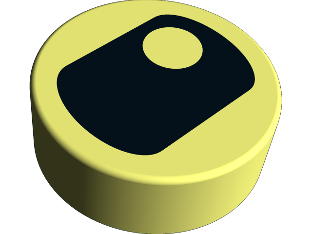

RE: Same color overlapping legal? - tang.dat
#10
Speaking of this kind of issue.... Is there any chance to see tang.dat primitives supported by LDView primitive substitution? That would help when there is no room enough to use a ndis primitive.
Reply
#11
(2016-12-28, 7:23)Philippe Hurbain Wrote: Speaking of this kind of issue.... Is there any chance to see tang.dat primitives supported by LDView primitive substitution? That would help when there is no room enough to use a ndis primitive.
Can you refresh my memory about what the tang primitives do?
Reply
#12
It fills the surface between the intersection points of tangents of ideal circle at 16-sided polygon vertices and  "polygonal circle" at current resolution. Can also be considered as a 16-sided ndis.
As I write this I realize that LDView substitution step is 8, not 16, so we should probably use that resolution. More bulky, but still much less than ndis.
Reply
#17
Thanks, Travis! Is it possible to get a Windows binary including this?
Reply
#18
(2017-01-02, 8:27)Philippe Hurbain Wrote: Thanks, Travis! Is it possible to get a Windows binary including this?
I'll try to send you a test build.
Reply
#19
Works perfectly, as you can see in this image (file here: http://www.ldraw.org/cgi-bin/ptdetail.cg...138p0k.dat)... what about a public release with this feature?
Attached Files Thumbnail(s)
