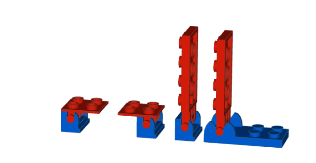

Hi Y'all,
I have attached a picture of a few hinges to illustrate one of the problems I am still fighting with re: a connectivity spec.
Mario posted an update to his connection model and the resulting discussion covers a model for connection meta-data that is pretty complete.
The issue I want to bring up here is: how do we (and do we even bother to) specify the travel limits for connections that have degrees of freedom (E.g. hinges). Such data isn't necessary for Mario's original purpose (assisted modeling) but it might be useful (in helping to stop the user from going past the legal end of motion for a part).
The question is: can connection travel limits be specified on a per connection basis, or can the data only be determined by looking at -pairs- of connectors? In the example I built, the male/female hinge plates have been swapped with part of standard hinge brick.
The limit when the 2x4 plate is inserted into the 1x2 brick isn't the same as -either- the limits for the plate with another plate or the natural limits for the hinge brick.
I could imagine a big table with pairs of connectors and travel limits, but this seems a little bit scary...
- The data is specific to the -part-, not the -connector-, which means we have to say which connector (on a given part) we are connecting with.
- Thus the number of data points in the table is going to be pretty huge.
- It isn't clear how we'd manage such data in the library - there are two parts the data can be attached to, or it could be in a separate table, but not being able to decompose by part is not good.
Does anyone have any good (or at least not terrible) ideas on this? I can try to put together some kind of straw man proposal but I can't help but think I'm missing a concept we need.
Cheers
Ben

I think the info at the part level should only supply it's own absolute limits. Any additional limits resulting from collisions of attached stuff is up to the algorithm using the data.
Problem here is those local limits are usually non existent as they would be completely depended on (very detailed) bounding box information.
So in short I agree with Mario it's a huge task to prevent unrealistic placement just based on connection info.
imho it can only be done (reliably) using full collision detection and or by keeping track of occupied connections etc.

Hi Roland,
Right - rotation limits would not be meant to do the job of general AABB testing.
The motivation to have rotation limits would be to get exact limits for absolute limits (e.g. a 1x4 hinge brick - it goes 0-180 degrees, end of story).
- These rotation limits could be easier for apps to access if they don't do full physics.
- These rotation limits could provide -exact- results; I'm not sure that AABB collision testing on the hinge is going to give us the precision we want.
You could argue that the whole thing should be done with AABBs, but I think that in some cases the AABB limiting the hinge itself is very 'tweaky' and would have to be significantly more precise than a general "don't let the bricks totally overlap" mechanism.
cheers
Ben

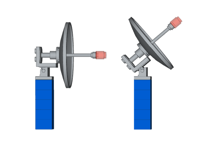

Let me also argue why non-physics apps might want this:
Quote:Reason for that is that there's very little use of the limited hinges without other "physics" anyway. For example, if I add a few bricks onto the hinge, the limit in real life would change. In a editor without physics other than the limited hinges, the limited hinge feature already becomes useless.
One reason why Alan asked me about connectivity in Bricksmith was that he wanted to be able to rotate groups of parts around their natural hinge point as an -editing operation-. In the attached picture, I built the classic space radar dish pointing forward because it's way, way faster to build when "on grid" - parts can be positioned rapidly on a grid without even having snapping.
But then when I want to tip the dish up, what I'd like to do is rotate a subset of parts around the hinge.
- In the current code, I have to manually enter the numeric rotate point as text. This is a giant PITA.
- With connectivity, Bricksmith would at least be able to know that the hinge has a rotation point around which to turn.
- With rotation limits, Bricksmith would also be able to know that the hinge can go from 0-90 and then must stop.
From an editing standpoint, this last case has the potentially to be a lot more user friendly: the rotation can be free and unconstrained by a grid and -still- not exceed the natural 0-90 bounds. For rotations where the user wants a tweaky weird angle (e.g. the angle is based on some trig relationship and isn't going to fall into a nice grid of every 3 degrees or 5 degrees) having the rotate be off grid but limited is the most user-friendly.
